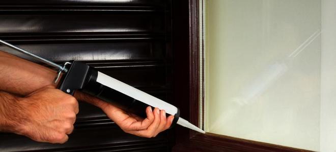

If the caulk around your windows is beginning to show signs of wear, then it's time to clean them up and apply a fresh bead. Use a putty knife or razor blade to clean the old caulk away and then simply re-caulk the windows.
