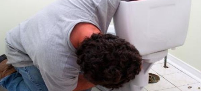

Changing your toilet is an easy project that should take half a day or less. The most common toilet has a separate tank that mounts on top of the bowl. These instructions apply most specifically to this type of toilet. If you have an integral tank/bowl toilet, a flush valve or a wall-mounted toilet, your procedure will vary somewhat.
Whatever kind of toilet you use as a replacement, follow the manufacturer's instructions. Fig. 1 shows the parts of a typical toilet.
