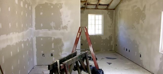

- Drywall can be installed either vertically or horizontally. Plan your installation so that the least number of seams are created. Use this criteria to choose the size of drywall for your project and plan the application before proceeding. Remember that when two boards butt up against each other at their long edges, both must have a beveled factory edge.
- Use a scraping plane or rasp on cut edges to smooth any roughness.
- When positioning the drywall panel, align the top of each panel with the ceiling edge or the angle break to assure a clean edge. To raise the panels you can make a foot fulcrum with two pieces of wood. Any gaps should fall close to the floor where a baseboard will cover them. All joints between boards should be positioned to meet over the center of a stud or rafter.
- Start a couple of drywall nails at the corners and across the top of the drywall panel before you lift it into place. Once the panel is positioned, it will be easier to attach while another person holds it in place.
- The best drywall nails have cupped heads which make them easier to cover when mudding and taping. Those with barbed shanks increase holding power and reduce "nail popping." Nail along the edge of the panel about every six inches, hammering the nail into the stud. In the middle of the panel, nail about every 12 inches. Check local code for variance. It is advisable, if the studs are new wood, to double nail in the field.
- Hammer each nail until it is forced slightly below the surface of the panel - this is called dimpling. Also be careful not to ding the edge of the panel when nailing or handling. Dings require extra mudding and finishing work. If you are using drywall screws, be sure you screw them to just below the surface of the panel. But do not break the paper when you do this. If the paper is broken, drive another nail nearby to assure a good hold. It is advisable to have a special drywall hammer or a cordless electric drywall screw gun for speed and ease of handling.
- Place nails in adjoining sheets directly across from each other where they meet at a stud. This makes mudding easier. If you miss the stud, pull out the nail or screw and dimple the hole so as to be able to mud and tape over it properly.
- Another alternative is to glue the drywall with drywall adhesive. The glue is used in the center of the board with nails used around the edges. Follow the manufacturer's instructions when gluing. The glue avoids seams that need to be taped and finished.
- As you apply the drywall, try not to leave a gap between boards more than 1/8 to 1/4 of an inch - less if possible.
- If required, get your nailing pattern inspected (check local code) before covering with tape and spackling.
